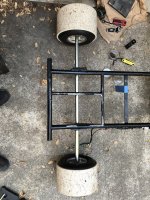

Rear axle is complete! I currently have my “drift tires” mounted. In other news, my cat Max has been massacring mice (which is new behavior) and presenting them to me as I work which is, um… nice? But I prefer to keep my workspace free of guts:lolgoku:

You better add some support out to the ends of that axle or it will fold like a cheap suit. Also add some spacers to keep the axle centered. Otherwise it looks good!
What do you mean by supports?
I have some locking collars on the way to keep everything straight :thumbsup:

The frame is so narrow, and there is so much axle hanging out from the narrow frame......any particular weight or hard bounce could bend the axe.
He's suggesting widening the frame around the axle, or extending the width of the frame so that the axle is braced only inches inside the tire.
Da Flash
Yup, Red understood what I meant. And locking collars no matter how good they are won’t keep the axle from sliding around. It’s best to cut tubing to slide over the axle to fit between the bearing and wheel/hub.
