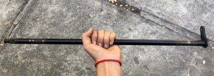

Working on Improving the overall turning radius of my kart. Step one is fabricating a new plate to replace the old one on my steering system. I have no idea what the piece is called so let me know if you do
Old:
New:
The old one is about 3” and the new one is 4”
