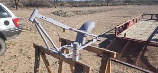

It was 71 degrees out, so I took advantage of the weather.
I used some locally sourced sand and gave the frame a once-over.
It did a good job of removing the stuff that was loose. Some of the paint was still pretty adhered, so I just let it do what it wanted.
My hose was set to max 120 psi. I noticed the sand blew better at 1/4 throttle. I turned the regulator down to 50 psi, and it worked better.
Dont worry, I had my safety squints on.

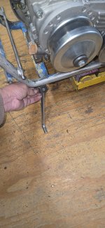

Hey guys.
Any one of you notice this never had a kickstand?
Well i better get one on before I start paint.
Got the only "weld on" I could find.

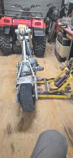

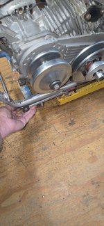

Put the engine back in and put the forks and wheels on to see where i could put the stand.
I think this will work just fine.
Then set an angle that looked good.
Measures out to like 12°
Ta dah!
