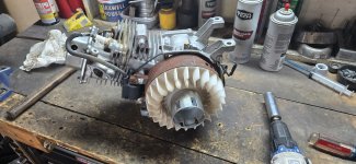

Crankshaft froze solid.
No new vent holes.
Stay tuned for autopsy pics.

And that was a stock motor of the power washer, right?
Yes. Unknown. It ran, so I just ran with it.
Riddle me this batman, on the bench it spins freely.
No funny noises. Still has a compression stroke. Gave a squirt and a drill spin and I got a few pops.
Im stumped.
Continue tear down and find nothing? Or stick it back and then what?

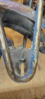

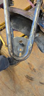

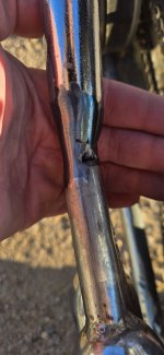

I stripped everything back down to the bare frame.

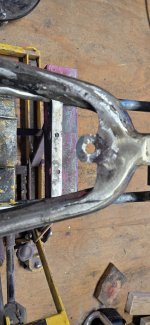

I found another badly rusted spot in the frame. I did the same as last time: I shoved a slug of metal in the hole, welded it, and ground it until you couldn't tell.
I got the axle mounting areas cleaned up a bit.
Not perfect, but much better.

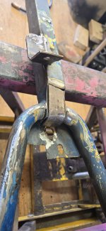

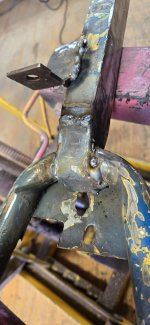

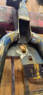

This is where I had to trim the spine for engine clearance. I didn't see the Bluetooth welds here. Maybe that's the cause of all the frame flex I was having.
Back in the scrap bin. Cut, bend, and trim.
And some awesome welding. That tube is so thin; it's hard not to blow through it.
And then I made a new tab for the seat mount out of some thicker stock.
Hopefully, there should be some room for spark plug maintenance.

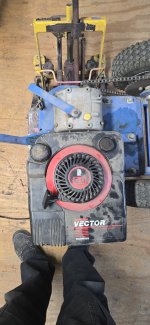

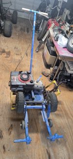

A side project came in the door.
Lets see who knows what this is.
Guy said the tank is always empty. Puts gas and next time its empty again.
I said is the oil over full?
Yup
Smells like gas dont it.
Yup
Time for a fuel shut off valve and an oil change.
Thank you for putting the drain in such a convient place Tecumsheet
