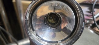

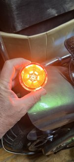

Picked up an LED 1157 equivalent for the tail light.
I got this kind just cause it had the out facing led board. Most 1157 replacements dont.
Take note of the lower board. The flange so to speak was too large in diameter for the socket to seat in the housing. See the black line printed on it?
The housing.
So some careful rubbing on the grinding wheel and now the diameter has reduced.
No more black line.
IT VERKS!!

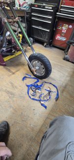

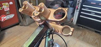

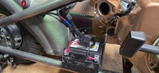

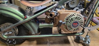

So as posted before, the front axle was crap.
Had some half fast busings.
Hey they tried.
Sloposys

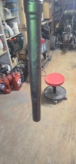

So I looked online for bushings. Couldn't find the proper size. Similar set was around 25 doll hairs per pair.
I ended up getting 2 foot longers of aluminum tubing with exact ID and OD I needed. A whopping $4 shipped!
I dont understand.
None the less, a quick trim and I have fitting bushings and a new axle.
I feel better about it now.
Peep the green forks.

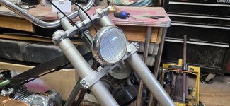

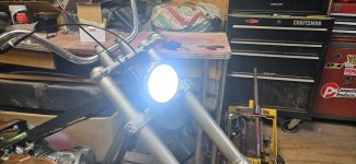

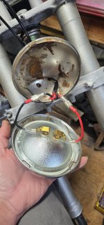

Where did you get the tail light? Where did you get the led? Where did you get the headlight bulb? Looks great so far.
Needs that fancy kick starter though.
5,042
4,446
Man you got alot of questions.

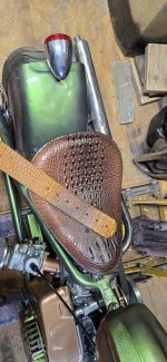

The tail light bullet was on the carcass of a frame picked up. I think it is a turn signal for some motorcycles. I measured the diameter and found a lens that fit.
I was utterly surprised I found one.
The bulbs are from Amazon. 1157 Led and a par38 also use in landscaping. So the 12v was easy enough.

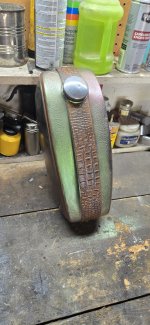

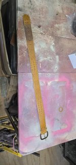

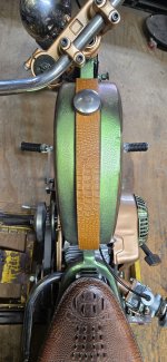

I question the authenticity of that 'comet' belt...:ROFLMAO:
The belt on the gas tank is just genius man.
Wicked_Daddy
184
296
Texas, Y'all
Dig the belt for the tank! Everything is coming together for the ultimate coolness in mini-chopper style. Does Easyriders come in a kid version? Cover story!
