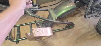

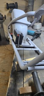

Got a gold filled battery the other day for this chopper.
I think this is the best spot for it. There's some tabs but not where I need them.
Good thing I keep the tiny wheels. Use em till you can't.
This should hold the back side of the battery.
Started adding some strap to help level the floor.

Found this bracket in the pile. Looks like it was made for exactly what I need it to be.
Trim off the excess and a couple bolts.
Abracadabra.
A battery hold down.

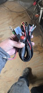

A wiring harness.
It came with a fuse, switch, relay, and 2 outputs.
I need to shorten it quite a bit and make a spot for the switch.

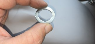

Took a washer that just happened to have the right size hole. Imagine that.
Made a few notches

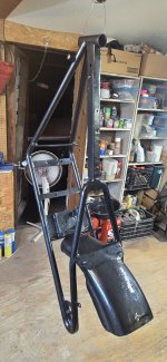

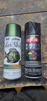

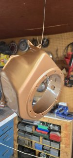

Thinking about paint.
Went over a few different ideas I just decided to just do a black under coat and get this rolling.
Ive been busy lately and days off have been terrible days to paint.
Too cold, too hot, wind blowing dirt everywhere.
Now to let this dry for a day before the color shift stuff goes on.
No, im not a crappy painter.
Well yeah. Im not great.
Thats hammertone paint.

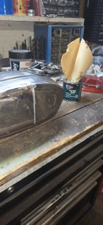

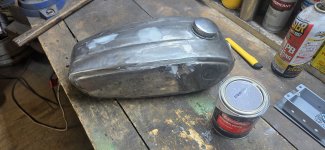

Im getting towards the end and dont want to ruin the reveal.
Here's some bondo on the tank to appease the masses.

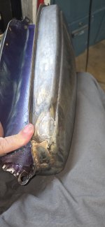

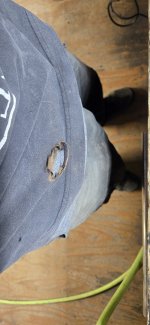

I started prepping for the tank sealer and found another big hole. Took it back to my dad to weld.
Got the tank sealer in.

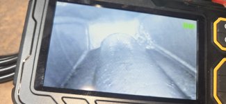

A view from my borescope.

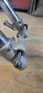

I also needed to address this.
The front axle fits like a hotdog in a hallway.
Parts on the way.
They say you can roll the sealer around inside the tank and then dump the excess back into the can to be used again… and again… and
