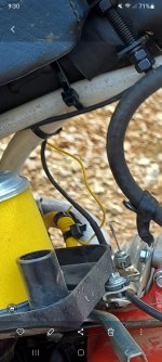

@goflight2
Use 1 zip tie to hold it on, with enough wire hanging to wrap 6-8 tight coils around plug wire, then 2nd zip tie to hold the end of the wire. Like this

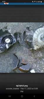

@goflight2
We gonna do some more testing & tuning today, or take a break???
With that extra 600 rpm you found, I gotta recommend you get that aluminum flywheel and key on asap, or you will end up with something like this. This will make for a bad day, with the time and money you have invested.
I turn those stock cast iron flywheels to 4200 rpm, but for only 2-3 seconds. I just don't trust em. They bad for your health, imo.
