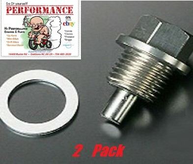

These will HELP keep metal off of those important moving parts. Especially, during break in. Your oil won't turn black so fast with these.

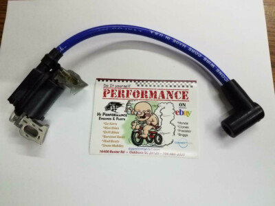

This is not necessary at the moment. It eliminates the "timing retard" the stock coil has. Better acceleration also. Pick your own color. Pricey, but well worth it to me, I have verified this with a dial back timing light. Will work really good with that new flywheel set at 28*.
Dont let any body talk you into those stage 1,2,3,4 magical, hocus pocus, bs kits. You won't need half that useless crap.
