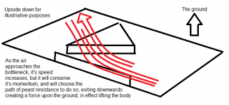

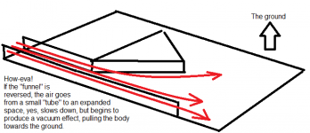

FA, the venturi principle you describe is 100%, and I am not trying to debate it. What I am suggesting is perhaps best illustrated: If you take a funnel (which is not unlike the underside of your delightful project here) and you pour - say - oil into it. But you pour it too fast and what happens? It overflows. The air rushing into your under-vehicle funnel will follow the path of least resistance, which is not rushing through a narrow opening. I am not a scientist, so the explanation of my point is being made poorly.

Hey Ez,
I really appreciate ya helpin' ta expand on this discussion
...for me & for everyone else too :thumbsup:
I think we are mostly "on the same page" :cheers2:
&/so
I gots some more jabberin'
Your first illustration
I agree, the Intake can't be too big, as compared to the Throat (or bottleneck) (kinda like what the jet does in a carb) :)
...or (as you describe) the (funnel) will overflow (or the engine will run too "rich"&/or "flood" the engine with fuel) :confused:
Your second illustration, seems to be describing the effect (I'm hopin' ta get from) of the Expansion Tunnels :2guns:
