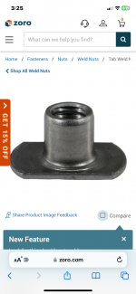

At the moment I can only think of one bolt that I would need to use such an insert. Because I spent all my money on the Kathy Ireland poster, I’ll probably just try to fish a t-bolt from the open end of the tube and put a nut on top and then hate myself every time I remove the gas tank.
This may end up looking Frisco style anyway. I don’t think I’ll be using very much of the tunnel in the tank.
I’m thinking if I find a plain steel threaded rod coupler 1.75” long, I could weld it on top of and perpendicular to the backbone for the front mounts of the tank. If the front mounts are lower (using more of the tunnel), I don’t think gravity and the tank shape and parallel to the ground backbone play well to let the tank drain.
1,851
Use a piece of tube instead of the threaded nut. A long thru bolt and nut. 2 tabs off the frame to your height.
Ya that was the other idea. I don’t think I want to raise the round tube any higher than the top of the backbone, so I don’t think I need the tabs.
I got some 1/2” OD 3/8” ID tubing that I ran a drill through for use with 3/8” threaded rod. I originally used this rod/tube for tie rods on a buggy.
I’ll probably use a 5/16” x 2.5” bolt for the gas tank front, through the 3/8” ID tube with tube welded directly to backbone.
