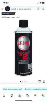

Wonder if I should try without this anti-spatter?
I’ve been welding through it. Mostly water I think. Maybe it drips into the weld?
The guy who I know that put the steering head on said he was only familiar with ceramic sprays with cannot be welded through. He started covering the area he wanted to weld and was surprised when I told him you should be able to weld right through it.
Maybe with such low voltage / amperage the anti-spatter coating causes issues?
1,865
In my mind. The water in the spray absorbs the heat as it evaporates reducing the amount of heat going into the work…
No idea if this is significant or not, but worth testing IMO.
