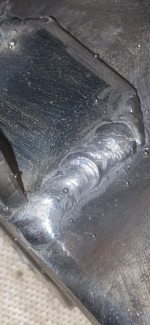

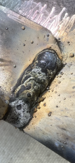

1,865
Maybe still a little cold?
Getting better I think.
This was wire speed about 9 of 10.
I’m not sure if age of wire matters? The old stuff was probably 8 years old at least. Plus have not using the anti-spatter the new wire.
Update: I guess shelf life is two years.
