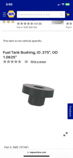

This tank is smaller (1.5 gallon vs 2.4) and more expensive, but might fit better. Slightly different mount style.
It’s about as wide as the seat and only 16” long.
The backbone is about 35”. The seat is 18” long but can hang off the back a bit. This length of gas tank gives some wiggle room.
