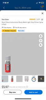

So Walmart had 6 pack of Rusty Metal Primer rattle cans for $6. It was gunna be $7 for a can of self etching primer.
