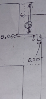

But why shim if I need to get somebody with a lathe to machine the pockets anyway?
If I had to shim the race, I would just not cut the pockets so deep.
The OD of outer race is about 1.61”
The ID of the “sleeve” (for the bearing pocket) is 1.50”
The ID of inner tube is 1.25”
The OD of protruding part is 1.29”

The thing to do, if i am following this correctly, is to weld the cup/sleeve thingies in place, then bore the clearance for the bearing.
The bore needs .040 off the diameter. How deep?
1,887
I believe 0.050” deep would be plenty.
I’m not good at drawing but think we are in same page.
In this artwork I believe I made the bore 0.050” off the diameter (if using your words correctly) instead of the 0.040”. To make the ID of that section 1.30” instead of the 1.29” I mentioned.
The 1.61” is just a guess for now . I forgot how tight the actual interference fit should be. This should be somewhere earlier in this thread.
The depth of the 1.61” ID cut isn’t that important. The race can stick out or be tucked a bit.
I currently have about 0.335” on one side and 0.350” on the other. The race height is about 0.355”. I think it can stick out 0.020” and be fine.
