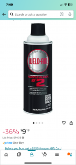

Im going to try to grab some Anti-Spatter spray.
