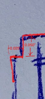

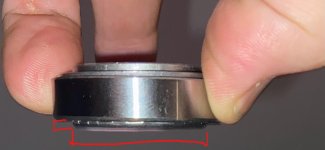

I think the bearing pockets need to be slightly more complicated than I originally thought.
It seems I need the pocket itself to be “stepped”
One shoulder for the outer race.
Then the inner “tube” needs to be opened up for part of the “inner bearing” that protrudes past the outer race. The protruding part is about 1.29” in diameter and the tube is about 1.25” diameter.
