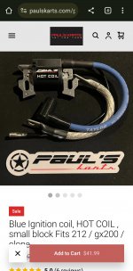

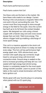

I use Dover Power performance coils
Me and a buddy checked stock coils with his dial back timing light, and non resistor plugs, pvl flywheel and a arc flywheel, while engines were running, and you could clearing see the stock coils start pulling timing out (retard) as the rpm climbed higher. Some started retarding at 4k, some 4500, and some didn't start til around 4800, but they ALL would retard the timing. At 6k, there was as much as 8* retard when using a stock coil.
So if you got your timing at 32* and using a stock coil, you will have only 24* at 6k. Make sense ????
We checked 3 Dover Power coils and only seen 2* retard at 6k. Steady climbing to 7k and still only 2* retard.
I'll never use any other coil on a performance build.
Paul knows his stuff, I'm sure he has checked his coils.
There's only 1 way to know for sure, gotta see it with your own eyes to believe it.
