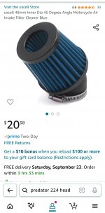

This is the filter im running right now so i shouldnt have to worry about that anymoreScreenshot_20230921_202701_Amazon Shopping.jpg

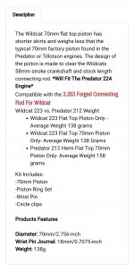

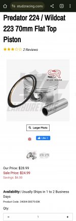

Honestly I think I might get these 2 it should come with everything I need plus I wouldnt have to lap any valves or anything that I have no experience doing lol, let me know what you think i looked on that link you sent me and i couldnt find just a stock pistonScreenshot_20230921_213400_Chrome.jpgScreenshot_20230921_213419_Chrome.jpg
aust9002
154
118

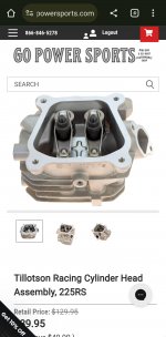

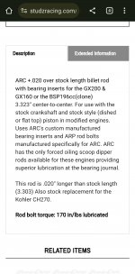

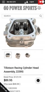

Ok so I think im going to buy these hopefully it will be a simple swap and can get me back up and running while I fiddle with the piston and other head, gets me to a flat top, with a .709 wristpin and made for the 58mm stroke, the arc 6271 billet rod, and the tilly 225rs head it comes with the 26lb valve sprimgs already installed too so I dont have to swap anything from the head and plus it has empty exhaust bolt holes so that would fix that too,
