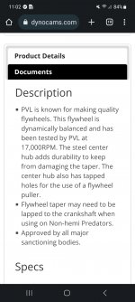

If you are willing to spend the extra cash, this flywheel coil combo will be the better option.
I use this flywheel on 90% of my builds. It's probably 1 of the 1st flywheels approved for racing and has been around a very long time.
It needs a flywheel puller to remove it, as does the billet flywheels, but that's so you don't break or crack it like the cast aluminum will do if its removed too many times.
The Dover Power performance coil is the only coils I use.
I have tested 3 of these coils with a dial back timing light and they DO NOT pull timing out (retard) like ALL stock coils do.
Read description.

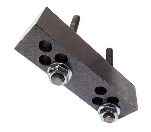

Did you get a flywheel puller??
Crack that flywheel trying to pop it off, will turn it into a $100. paperweight.

No, I figured I'd get one when I needed to remove the flywheel because I'm thinking it's not a part that I'll need to remove any time soon. Am I wrong? Is pulling the flywheel something I'll probably end up doing soon?

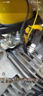

Thats odd, its usally in the 2nd or 3rd hole. The last hole to the right is the right 1.
Check and make sure your throttle cable has not slipped inward. Those hold down clamps are not the best. I put a small piece of rubber tubing over the cable to get a better grab.
Send pic of you throttle cable hook up. I might see something different.
