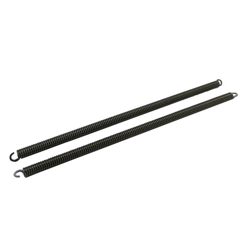

You can also take out 1 stock driver spring and replace it with 1 white spring. This will allow the engine to stall up the driver to about 2600 rpm before it starts moving the tires. This puts more torque to the tires and less falling on its face when it gets into high.
2 white springs, will be around 3100 rpm, but you need to have more then 3600 rpm outta the governor.

Here those driver springs, you can find them anywhere.
