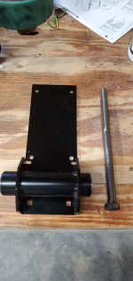

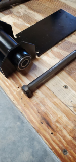

So I got the Clutch Mount with Jackshaft today from BMI. Before I mess something up, I thought I'd get some incite here on the proper way of inserting the shaft. Should I remove the bearings and put them on the shaft and then install shaft and 1 bearing and then slide the 2nd bearing onto the clutch side or should the shaft slide right in with the bearings on the mount?
I am sure it would be ideal to grease everything up first, any specific recommendations or just some motor oil? I do have some Dry Moly Lube and Chain Wax coming in sometime today.

I would ask the vendor first, that way if something goes sideways while putting it together you can blame them. Probably a little wheel bearing grease will allow it to slip in pretty easily.

The thought crossed my mind as well to ask them. Thanks, I'll shoot them an email

Chain Wax chain lube or any other chain lube is for chains. Use either grease or oil to slide shafts and bearings together, I like grease myself because it doesn't run off like oil. Do not use any dry lube on those bearings, and don't use any wet lubes on the pulleys. Mount the bearing plate, slide the shaft into it. After everything's assembled and locked down, standard good practices dictate wiping away excessive greases, oils, or lubes to prevent attracting and holding dirt. Dry lube your pulleys.

On a shaft like that what I would do is gently knock the bearings out. Remove the seal from the side that faces inboard on both bearings and before reinstalling them I would drill and tap the center of the tube for a grease zerk. Clean out all shavings from the tube and install zerk. Then get a tube of marine grease and load it up in the old grease gun. Reinstall the bearings open side inboard. Then pump that sucker full of grease until it starts to come out the center of the bearings where the shaft goes. Install the shaft and give it about 4 more pumps after the shaft is installed.
Now what that will do is make sure the bearings are well greased all the time and seal it all up to help keep water and fine dust out of the bearings. It will also help keep the bearings cooler always having a fresh supply of grease. Keeping them cleaner and dryer longer increasing their life. Then every 10 hours or after riding in mud or water just give it a pump or two of fresh grease. Water proof grease is usually green in color and available where ever grease is sold. Just one of my little tricks. Rarely lost a bearing in 40 years.

I'm not so sure I'd knock the bearings out. First, there's the chance of ruining the pressed in bearings. Second, those are sealed bearings. Adding grease and fittings won't help because they're encased so no water or grime gets in them plus adding grease will attract dirt. The inner race rides on the jackshaft "bolt." A slight bit of lube to help slide the shaft in is all you need if that. If you look at the bearing, it's sealed. Adding grease won't accomplish anything in my view.

You may need glasses then. If you reread my post you will see I said to remove the seal on the inner facing side of the bearing. It does a lot of good. Remember that is the shaft with the highest speed next to the crankshaft. With a good supply of grease the bearings are much happier. The extra supply of grease will also help seal to keep out contamination. Everytime you add grease it is like repacking the bearings.
One other advantage also is you get to clean out the boiled yack grease the bearings come with from the Chinese factory.

Those are actually high speed bearings, designed to work in situations like this. Personally I wouldn't chance destroying brand new bearings under warranty.
  • The clutch mount has (2) 5/8" high speed bearings pressed in.
