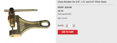

Please do not get yourself one of these chain breakers, it's the one I have and hate. You must be able to support the back side of the chain as the tool's pin pushes the roller pin out, or the side plate just bends away and you have to fight with some Channelocks and a screwdriver to get things apart. Then you've got side plates that aren't flat anymore, and end up with a link that doesn't want to swivel................
Chain Breaker Tool #25 thru #60 | AZ4097 | BMI Karts And Parts.............thought P.O.S. was retail speak for Point Of Sale? Guess again. Next time I use one will be after I have the one from GPS you posted above for $8.95 in my hand.

That one I linked from BMI Karts is the one I have and hate. Really didn't know what it took to have a properly working breaker until using that thing, what a Piece Of S___ (POS). Here's the link again, PLEASE DO NOT BUY! Chain Breaker Tool #25 thru #60 | AZ4097 | BMI Karts And Parts
In the video with the picture you posted of the 2 chain breakers, you can see a good example of what I mean by needed to support the back side of the chain. That style has a jaw above holding the pin that screws down, but it also has a jaw below to support that side of the chain. It keeps the outside plate from going anywhere, that is, from bending down. Instead the roller pin just pushes right on through the lower jaw.
On my POS breaker (just linked above) the chain is grabbed on the sides around the roller you want to push the pin out of. The pin starts to move, then instead of slipping on through both plates, the bottom plate literally bends and spreads apart. The pin is then stuck, and you have to grab the bent plate with Channellocks in one hand and try to pry things apart with a wide flatblade screwdriver in the other hand.

I'm going to get the general type of breaker in the video above, but unsure about size ratings and replacement parts..............
This particular one............Heavy Duty Chain Breaker | 600107 | BMI Karts And Parts..........for $8.95 says it only fits chain sizes from #420 on up to #530, and it specifies its extractor pin as being 1/8" diameter. This chain spec chart...........Chain for Go Kart, Mini Bike | GoKarts USA®............specs #35 and #41 as having 1/8" roller pins which that breaker isn't sized for. #420 has slightly larger 5/32" roller pins as do the larger sizes beyond it that the breaker's rated for with its 1/8" extractor pin. Clearly they don't think a 1/8" extractor pin should be pushing through a 1/8" roller pin, guess it's just too tight.
But then there's this way more expensive $35.95 breaker.............Deluxe Chain Breaker Tool | AZ4899 | BMI Karts And Parts............that says it fits from #35 (1/8" roller pins) to #60, but doesn't disclose its extractor pin diameter. I want to know if it's saying an undersized extractor pin is okay, and therefore it's best to buy the universal fit chain breaker, 'one size fits all'.
EDIT: MFG Supply chain breaker...AZ4899 - Deluxe Chain Breaker | Go Kart & Mini Bike Parts | MFG Supply...........for $34.99 has replacement pins ($1.29) for its universal size..............Replacement Pin for AZ4899 Deluxe Chain Breaker | Go Kart & Mini Bike Parts | MFG Supply...............which was my main concern, that's the part that can be damaged. So MFG Supply it is, one size fits all, buying it just once for life, and some spare pins too.

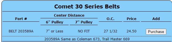

USAMSC, In order to use the 5959 belt that's suggested, you'll need to make sure the distance between the drive pulley and driven is 7" or less. Put the jackshaft on the engine plate then set the engine on the jackshaft. Measure for the correct distance. The stock jackshaft sits about an inch high from the engine mount plate. If it's close, slide the jackshaft sprocket on the jackshaft, grab your chain and fit it correctly by wrapping it around the axle sprocket and the jackshaft sprocket. I do what someone else suggested earlier to break the chain. I figure out how many links I need to remove or add then use my battery powered grinder to knock off the top of one or two pins then drive them out with a punch smaller than the pin hole. This method eliminates bending a side plate on the chain, just make sure you don't grind the side plate too thin on the chain. I would double check to make sure your axle sprocket isn't a #35 by grabbing a 3/8" open end wrench, placing the ends over the tops of the sprocket teeth and checking if they match. If you have a #35 sprocket you'll need to get a #35 jackshaft drive sprocket and chain. Use an impact wrench to tighten the nuts on both pulleys once everything is setup properly and always lift the rear of the kart off the ground before you start it. Be ready to shut the engine off in the event things get ugly.

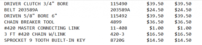

Here is the one I ended up getting.. it appears to be the same thing and has a broad purpose as well, but doesn't work with 60 chains.. I also don't see replacement pins available from GKS.. Hopefully, it works out to be good enough.
Before I tore everything down and had ordered my first kit, I actually measured per a video I saw from Red Beard Garage YT channel, at least I think it was him. Anyhow, I know the space was between the two shafts from each's center, less than 7" and I believe it was 6 5/8, but I am not 100% now, as that's been about 2 weeks. I am still waiting on the new plate to come in, so I am unable to do that now, but if I have to order another belt, that's not a huge deal, as that part is pretty inexpensive.. Maybe GKS will let me exchange it!
I have measured just about everything with a 1/2 Wrench confirming I have a 420 and will be setting up with exactly that for everything going forward. Here is exactly what I ordered from GKS and is most of my parts ordering, tools and lubes and the new plate were all purchased elsewhere.
