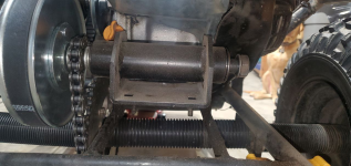

So, I ended up pulling the original mount that came stock and slid it right over the bolts that change the elevation of the motor. I would have had to clean up the steel on the original better.
So I have a question for you, I feel like I've seen stated elsewhere that it's ideal to have as little travel in the chain as possible.. To have it so that the sprockets are as close together as possible without touching. I didn't go for this, but maybe I misunderstood?

There was no factory mount plate/jackshaft or chain, previous owner tossed them or something. The BMI Karts jackshaft works good, I wanted to set it up like it was originally, that's why I went with the spacers. Can you provide pictures of your jackshaft setup? I'll do the same once I get mine running which should be today.
Are you saying the shorter the chain, the better? I don't think it matters as long as the tension is set correctly and there is no interference anywhere. The position of the jackshaft sprocket and the axle sprocket won't change, they're fixed. The 5959 belt was still with the kart I picked up, it fit perfectly.
It's been bandied about before, and I pointed out the simple physics of a 8" diameter axle sprocket being right up near touching a little 12-tooth sprocket on a clutch. The angle of attack of the chain rollers on the small sprocket was such that the chain only transitioned about 90-100 degrees around the small sprocket, therefore barely engaging enough teeth to grab the chain under load. Others said it was never a problem, and I'm sure it wasn't for them. I just don't like only having 3-4 teeth grabbing the chain. A further spread between different size sprockets gets more of the small sprocket's teeth engaged.

Yea I guess, I just thought ppl here all agreed on that one thing lol.. wrong assumption.. glad to hear it doesn't really matter.

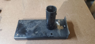

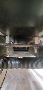

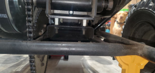

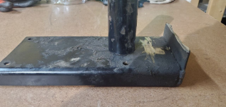

My kart actually had 2 plates. The new one replaced the 2nd/top plate which had the jackshaft part on it. Hopefully, these pics will clarify.
Here's what I took off:

What was the previous owner hoping to accomplish by hacking up the original jackshaft? I didn't get to mine yet, ran around looking for a few more nuts and bolts. I'll get pictures tomorrow, it's setup with spacers.
🤷‍♂️ You got me!
