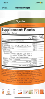

Speaking of urine. I’m going to attempt to make a DIY enzymatic pet stain carpet cleaner.
My best bud has developed a habit of wetting the carpet.
Meat Tenderizer has bromelain (protease) which breaks down proteins.
This enzyme capsule also has amylase and lipase. Not sure what each enzyme does. Says breaks down fats, proteins, and carbs.

Distilled white vinegar works wonders. You can use Cider Vinegar in a pinch but it neutralizes everything even when there is a "favorite spot"
