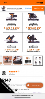

Or maybe this one for a few more bucks. $180 on Amazon.
I think it can make compound cuts in larger material than the non sliding 8.25” compound mitre evolution saw EZ^2 posted (shown in last photo).

The one I just posted seems like the best of all worlds. I’d get the 8.25” non sliding one, but I want to be able to do compound cuts in 2.5x1.5” rectangular tubes.
It seems this saw is the most versatile saw in my price range that isn’t listed as a wood saw with the capibility to do the cuts I want in the material I have.
This is why I GAB. I’ve learned a great deal about cutting. Thank you for your assistance.

That last one will definitely serve it's purpose well and then some... not that you plan on building or rebuilding a deck or anything, it's design is just all around versatile for sure
