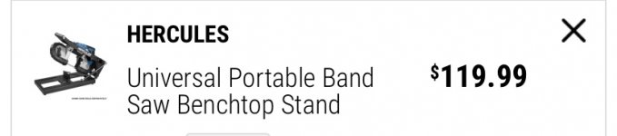

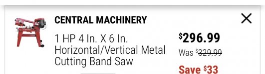

What type of saw should I use to make angled cuts through 1/8” steel tubes, the largest being 1.5” x 2.5”.
I was thinking this portable band with table.
It is about $230. Or this band saw about $300?
It seem the small bench comes only set up for 30/45/60 degree cuts?
Other options? Better? Cheaper? I have a sawzall, an angle grinder, jigsaw, oscillating multi-tool. My circular saw was stolen and never replaced.
Do I need a new tool? Everybody loves a new saw. The larger bandsaw will cost about $340 after coupon and tax with fee included to get it delivered. I couldn’t change to pick up option. IMG_5274.jpegIMG_5265.jpegIMG_5268.jpegIMG_5276.jpegIMG_5271.jpegIMG_5272.jpegIMG_5273.jpegIMG_5267.jpegIMG_5270.jpeg

Maybe I’ll just get a stand for my angle grinder?
Can’t really afford a new tool right now, but it seems a sliding compound dual bevel mitre saw would be the most versitle. The larger the better.
Are these saws variable speed?
Some of steel cutting blades say max rpm 2000,
but the saws give no load speed of like 5k rpm. What’s the difference between a chop and mitre saw? Do they turn at different RPMs or just that they use an abrasive disc?
