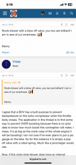

The idea of running the blower without a bypass but having it driven by a centrifugal clutched shaft was shot down because the blower would just be a huge restriction at idle. Not sure if that would make it inoperable at low rpm?

Perhaps the confusion stems from me wanting to use the wrong type of valve.
Without fully thinking it out, this is the type of valve I was thinking to use. Still need to think about it. These pics might help me. I will stare at them until I understand.
