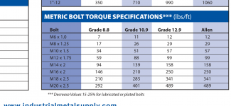

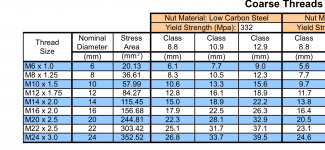

The 16mm long bolts engage 8mm of 10mm into the threaded holes in the hub.
I looked it up and saw one place saying you need around 10mm for 10.9, and maybe 8mm engagement for weaker bolts.
I’m sure I didn’t torque down to spec for 10.9 grade.IMG_7285.pngIMG_7286.png
