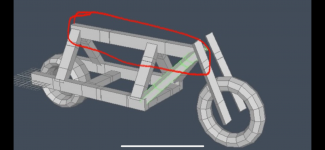

This should be close to the actual build.
About 25” from floor to top of “back bone.”
Reminder: Backbone is 1x3x 1/8” x ~35”
1,880

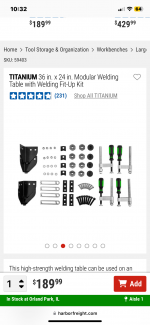

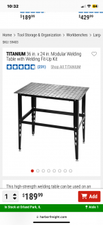

Now I probably need some magnets and was looking at that this fixture table. It 24x36”
And it is really thin. 4mm top is close to 5/32”
I’m going over different ways to complete the frame besides the ole sawhorse shape.IMG_7024.pngIMG_7025.pngimage.jpg
1,880
Maybe a single down tube, single cradle?
Then some gusseting to support the edges of the engine mounting plate?
I think the original idea I had was a double cradle with the engine plate suspended (by weld) to the bottom of the dual cradle rails?
The steel I have for those bottom rails are pretty hefty.
1.5 x 2.5 x 1/8” IIRC
The steel I have and plan on using for down tube(s) and to connect the bottom rails to top backbone is 1” x 1.5” x 1/8”

I suppose splitting the difference would be something like this…
Single down tube… Double cradle?
But pointy instead of bendy?
