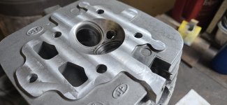

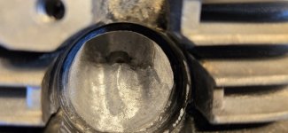

This is the exhaust port. Major restrictions going on here. Let me just take some weight off too. I heard it makes you go faster.
PPOV.
Pistons point of view.
Man, this camera really picks up the rough surface. It looks and feels smoother than it shows here. I'm still gonna go at it some more with some sand paper and a finger. 👉.

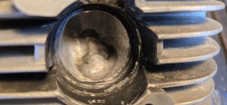

Did you see my oopsie?
I was just saying I'm done here. Get to polishing and quit hogging.
Made a new exhaust leak.
Now I gotta head to my dad's and use the TIG.
Hope I can get it patched without having to pull the valve guide.

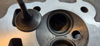

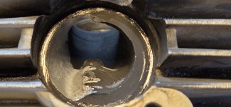

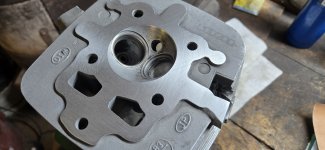

Glued some aluminum back on the head. Yeah it's ugly. My sharkfin was a first attempt for me. Roast away, but I'm sure it will flow better than it did.
Did a little cc calculation. Bore and stroke came to 193cc. Funny cause the case stamping says 171FFM. Which translates to a 71mm piston. This one is 63mm. I thought I had a 250cc but got a 200 instead.
Head came to 22cc and the domed piston was 11cc. Gasket was .9cc.

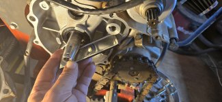

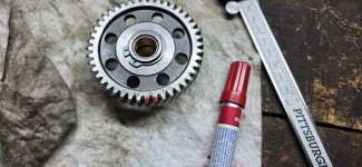

Putting the cam in wasn't hard but I had to sneak peek the dots. The seal has to be removed to see the dots. I wasn't gonna mess with it.
So some paint and a mirror. Works for ugly girls. Why not.

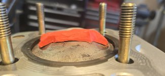

Gonna get clay and measure the piston to valve clearance. That 2mm of lift is gonna make it close. I've read guys getting 1mm decked and are ok but I don't know if they did a cam or not.
1mm is real close to .040 freedom units. Or a banana slice for scale.
1,846
What kind of clearances are needed for comfort? On the 212 engines I’ve played with I think I aim for about 0.030” piston to head clearance and maybe 0.065” exhaust valve to piston. 0.050” intake valve to piston? I don’t remember what basic guidelines are.

Glad you asked Bob!

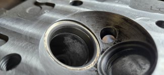

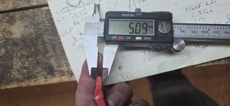

Twiddling the slide rule a bit i got 8.5:1 compression ratio.
If I deck 1mm or .040" I'll be real close to 10:1
After milling I'll be at 4mm or .160" roughly. As you can see by my dollar store calipers, I'm at the utmost of accuracy.
Notice the quench ring? On the outer edge of the combustion chamber. That's about the 1mm deep and will remove a considerable amount of volume. Maybe 1.5 to 2cc.

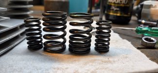

Today's quiz everyone. No cheating, keep your eyes on your own paper.
Progressive springs. On a valve, which way is the proper orientation.
Please explain your reasoning and show your work.
I'll will check in with your answers later.
Free refreshments and centrum will be held in the cafeteria afterwards.

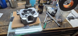

Ended up taking .035" off.
I had .040 in my head but I was getting close to the valve seat. So I just stopped there.

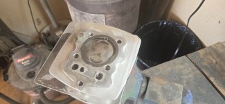

I have a 12x12x1" bullet proof glass panel i use as a surface plate. You can see where some one took a few rounds to it. That's on the bottom. Top side is perfect.
All pretty and smooth.
CC'd the head again. Got 19.5cc
I don't estimate very good. I was shooting for .040 off and about 1.5 - 2cc lost.
I got .035 off and 2.5cc lost.
It is what it is.
Dug my abacus out of the drawer and figured my new compression ratio to be up a little over a full point.

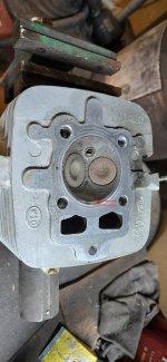

Lapped the valves in and put it all back together last night.
Gonna do some vrooming later.
I'll let you know.
