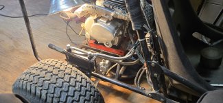

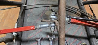

I think these will work.
Then I installed them and realized I need some off set spacers.
Some of your keen eye might spot the problem.
Dont have any ⅜tube to make some.
Hmm.
A split washer is pretty thin in that direction and just might be thick enough to make the clearance I need.
Hey lookie, they work.
And now with 4 lock washers it should never come off again.
And I just realized. The pitman arm and the steering shaft is the only thing I haven't touched on this one.

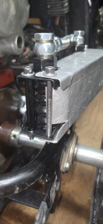

Yes this was the OEM manco dingo rod end.
Soft metal. It just pulled the threads.
I was wondering if, in their cost-cutting mindset, those heim joints were constructed in a way that the threads were pressed into the metal (around a forming die?) instead of cut the old fashioned way. Even cut the old fashioned way it’s still quite economical as it’s two sheet metal halves pressed around the ball joint, lickety-split.
The bore has no threads in the corners due to the almond shape.
You can tell, whichever way they assemble it, that the threads are cut (or pressed like you say) before the halves are pressed together. The pointy end of the "almond shape" has threads going into it, in a sort of curve, it looks. Looks like the threads are there, they just wont grab anything.

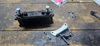

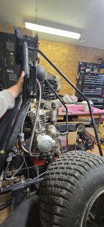

I decided I'd up grade a bit. Add an oil cooler.
They make 2 kinds for this engine.
One you get a new valve cover that has the pressurized oil passage tapped and the return goes back to the valves.
The other, more common, and the cheaper one I got uses a plug that replaces the oil screen just before the pump. Its a Negative pressure system.
Not too keen on that idea, but it works.
I like the love note they send.

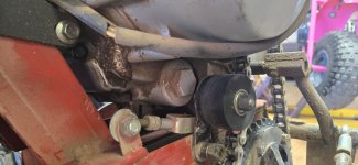

It replaced the pre pump screen behind this plug.
Shouldn't be a problem except i made the chain go a non normal direction. My tensioner is in the way.
Here's the new screen filter. Thay made it in line. And of course its all full of machining crud.
5,039
4,437
Moved the tensioner and added a link to the chain to go from here.
To here.
Got the new plug installed.

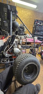

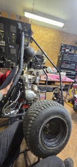

Now I've got to decide where to install the radiator.
Up high.
Medium.
Or down low.

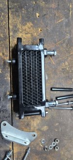

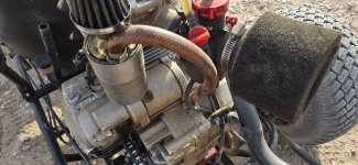

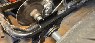

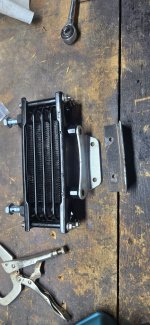

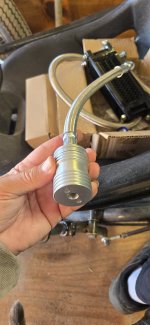

Here's a few more pics of that cooler.
It came with the mounting bracket on the same side as the oil lines.
Took it apart and swapped the end plates and made the mount on the bottom.
Dug in the scrap bin and found a chunk of angle iron that was just right. Drilled a couple holes.
A few good tack welds and a squirt of paint.
Got it mounted. Filled the cooler and attached the lines. Ran it for a bit and could feel the heat building in the radiator so I felt better about the flow.
I decided to put it on this side cause the lines ran better and it was kinda busy on the other side with chain and shift links.
Best part? So far no leaks.
But I still managed to bobble the funnel as I was topping it up and dumped oil all over the brake rotor. Good thing for carb spray.

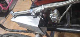

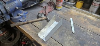

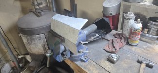

Started making an air scoop for the oil cooler.

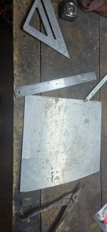

Some flat aluminum i dug up from the pile.
Made some marks and started bending.
A little more tappy tapp tap and I have a wedge.

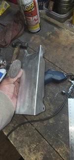

A bit of trimming and im getting close.

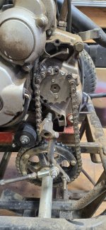

Had some family over and zooming around the yard and my 20yo nephew thought he could race me on my own track and karts. Ha.

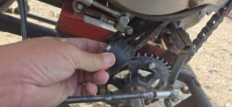

Then the chain jumped off the sprocket and locked it all down.
Wadded up so bad i couldn't rock it back and forth to free some slack. Had to break a chain link to get it untied.
So let's fix the problem. Again.....
The output shaft has a groove cut in it like for a snap ring. I have to flip my sprocket out board of this ring and lock it in from the inside for clearance issues. The chain wasnt intended to exit downward.
I figured id drill and tap the shaft and put a thick washer and bolt to hold the sprocket tight. There's a lot of wiggle the way its made.

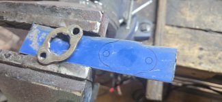

Trace my bolt pattern.
Cut it out and make it pretty.

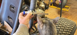

Got my measuring stick and this washer will work just right.
A little hot glue and I have a button.
Bolted on and plenty of chain clearance.
The sprocket wiggle no mo.

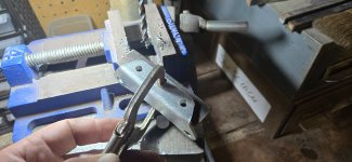

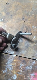

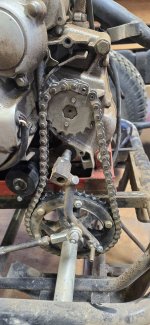

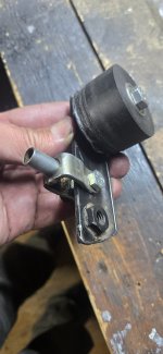

In the chaos of that chain of course it took out the tensioner.
So ive lost count of how many times I've been here.
The thin metal just couldn't hang.
I tried to bend it back but I just knew if it failed once it will fail again.
Im still not sure which caused the derailment, the tensioner giving way and the chain went slack, or the sprocket wiggle jumped the chain and the tensioner was just an innocent bystander.
There's a bit of side load the way i made it so im not surprised.

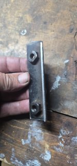

Lets try this reject from another project. Its much thicker and has a curl that will definitely add some rigidity.
And bonus nuts.
In the right spot even.
Drill a hole for the push rod and bobs your auntie.
Lets see how long this one lasts.
