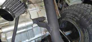

Using left over parts for other things is always good. Used the chain tensioner bracket from the donor quad to make an exhaust brace.
Mas better.

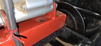

I thought a few days would be enough for paint to cure. Guess not. Dribbled some carb clean. Whoops.
