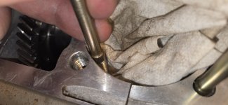

Got a helicoil kit, so here goes.

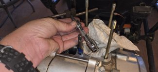

Had to make a tap drive to clear the other studs. 12pt 9mm socket fit the square of the tap close enough.

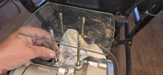

Used a plate glass to eyeball my depth.
20250301_170343.jpgstarted the insert and kept driving it down till it was at the depth I needed.
Used the glass again as I set the stud.
Hope it holds.

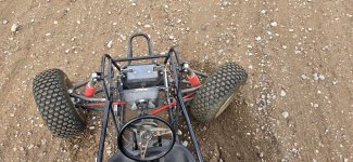

Then I left the home track.
There's an abandoned roundy round track that has been kinda converted to a MX track in the near city. I've been wanting to go see what was out there and if there was any sorta flat track left.
Unfortunately there was no fun to be had for this hard tail. It was just too rough. Kinda like a boat in rough water. I just couldn't get it on plane.

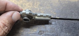

Were you turning when it broke?
I recognize those heim joints as fun kart, OEM Manco style (of course). Is it really just two pieces of metal (crimp threads?) pressed together and that’s all or is their there an inner core? I suppose it’s ripe for a high-speed, high-stress failure, but honestly you don’t really expect them to be a weak link (no pun intended), you expect a tire to blow first or something.
I’d like to see it taken apart and to see how they manufactured it.
Well this was a fun break at 45mph.
I wondered how well the crimp threads would last. Guess it's time for one piece rod ends.
