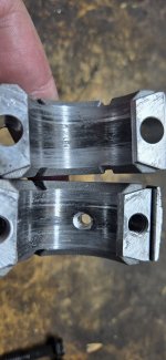

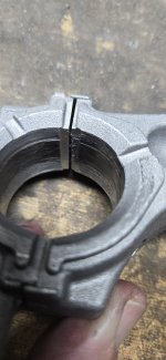

Pulled the 301 apart.
Look here class, this is why you buy the billet rod from the get go.
The rod is .010"-.012" out of round.
The crank has some marking but I can't feel it with my nail. I'm gonna try and see if polishing it will clean it up.

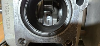

Rings came in. And they are the right ones! Now that I know I can proceed, it's time to order a rod.
Here's a new one with .018 gap with is good. And the old one in there to show how much wear it had.

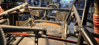

Too late now, but in post #29 I noticed you have the "Manco" pedals the wrong way around. The right pedal is on the left and 180° off and vice versa for the left pedal.
You have a piece of vertical tube welded in front of both pedals now, if I saw it correctly, which impedes the pedals but moving the pedals around might mean a more comfortable foot angle (as intended) and the upright on the pedal acts as a lateral footrest and "pocket" that holds the feet away from the spindles and spinning wheels. Anyhoo, I figure you did it for reasons.

The pedals. Yeah yeah. Dennys already called me out on those. That just fits the way I have my feet. I'd tried all 4 variations. Both karts are that way.
The foot box changed when I added the front end. It's a little uncomfortable now.
I did find some funky pedals that were straight instead of the curved. I'm gonna try them.

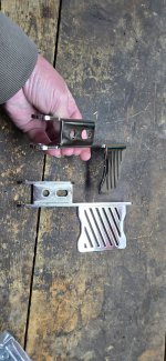

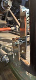

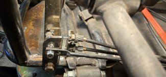

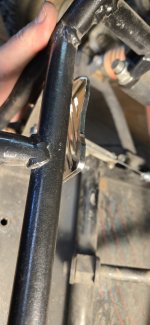

OK pedals came in. I got the Purdy Shiney ones instead of black. Shiney is faster, right?
Had to trim some metal here and there to make em fit. But this is normal.
The differential cable pull fit nicely in side the pedal and the supplied bolt fit the bore size perfectly. I had to drill a new hole in the right spot but it works great.
The cables are the front drum brakes and the rod works the hydrolic rear. I can adjust the fronts to match the rear stop power.

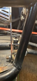

Here's the throttle. My cable was never long enough so I made a spanner out of some aluminum channel I had. The new pedal had a hole here. A carbide burr made it clearance better.
The throttle hits the frame at WOT.
And here's the finished look.
Yeah I see it. They're backwards.

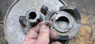

Finally got around to buttoning up the 301. Figured I'd maintenance the cvt while I had it apart. How's this key look?
Jut turn it 90° and keep on.
Nah I cut a new one.

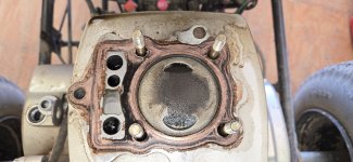

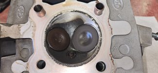

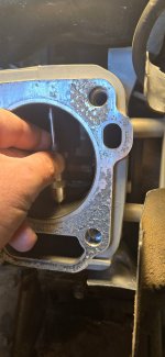

A head stud pulled the threads in the block. Gotta see how bad it will be to put a helicoil in it.
Here's the head side. You can see the washing on the top side.
And the mating surface. It's full of oil.
The lower right stud is in a oil galley that feeds the valve cover.
Someone warned me about the rubber intake manifold. Here's your " I told you so".
Maybe a few hours on it.
Gonna have to get a solid one or make my own.

My concern was drilling and taping the hole and keeping the crud out of the case. It's a through hole on that stud. Not a blind hole.
While I had the chance I measured the ring gap. .025 top and .015 second.
A little large. I was under the assumption this was a 63.5mm. I measured it at 63mm. Glad I don't just blind order for this engine. Nothing has been "as advertised"
