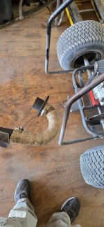

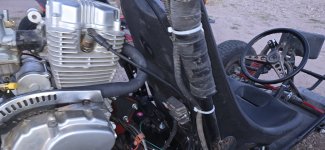

I'm gonna have to wrap the pipe and or make a shield.

Made a little more progress.
Got the pipe wrapped with a remnant i had. Hope that helps.

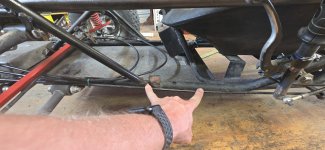

Still had some frame flex from the floor being only the 2 rails.
Again raided the scrap pile for some old reclaimed water pipe. Put a bend in them and made upper rails.

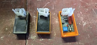

Also picked up a "performance" cdi box. Ohh it's orange!.
Put it on and it was hard start.
Put my dumb timing light on it and I saw two marks with no indicators.
The flywheel has 4 marks on it.
"T" for tdc
"F" for fire. The stock cdi box fires here.
Then a few inches around are 2 unnamed marks. I had tondonsome digging and found on a different Honda flywheel they put 29° and 32° btdc.

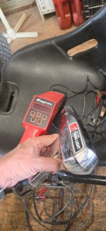

I borrowed dad's smart light.
It didn't like the cdi and or the wasted spark.
Said the rpm was 3200 at idle and very jumpy.
Don't sound right.
With the stock cdi I could delay the flash and get the T lined up. Said 20° that seems alot.
Popped the orange box in and it went to 68 or 70° advance. Again i was confused.
Laying in bed insomnia is my best thinking.
Duh. Wasted spark. I have to half the numbers.
So I'll throw out the rpms. And the timing would be like 10° at idle with the stock box, seems more like it. And the orange would be closer to the 28 -30°
I'm sure the orange box just eliminates any curve and just full advance. Haven't road tested it yet. Supposed to have removed the rev limiter too.
Deep research says the stock cdi boxes perform better than the various colored hot rod ones do anyways.
It was 9 dollars. I had to try.

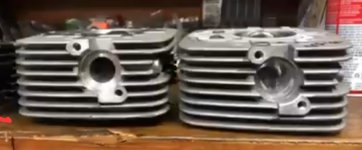

Here's a guys work on one's he sells.
Stock vs gasket matched.
Reviews on the cam and head porting are good. Goes from meh to poppin wheelies with no gear change.

View attachment 149774View attachment 149775

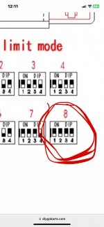

I put the orange box in and it idled at 1050 or so. That i expected. Made some hot laps and i saw 4500 which is higher than the other box and it felt like it would have kept going. I had to back out. Tracks not big enough.
The larger orange box is adjustable with 8 different curves. I haven't tried it yet. Not sure how to work it. No instructions. No sticker on it. Nuttin.
I had a go on the search for this. I'm still not sure what's going on. Lol
Any one fluent in chinglesh?
1,859
I watched a video in a language I didn’t understand but I think he liked the adjustable cdi box set with all 4 switches “up” … I guess it is “speed limit mode 8 12k rpm”
Low RPM and High RPM are spoken in English, but I can’t really understand the rest. I’m not sure what the first switch does. Race Mode vs Speed Limit Mode.

I played with the adjustable cdi for a few minutes. All down seemed to run OK. Any other position and it ran horribly. Shook badly. Not steady spark for sure. Took it out and put the plain orange one back in. Seems to like that 28° advance.
Low end is alot more spunky.

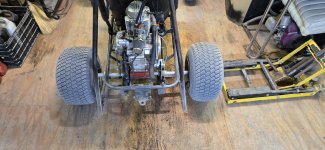

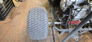

Check this out. What do you think.
Same psi. The rounder tire has stuff inside. You can hear it rolling round. Never been flat. Never been off the bead. It sounds like gravel inside. I posted a video earlier and pointed it out. These pics really don't show well.
Im wondering if a belt broke inside.
Any of you seen this before?
