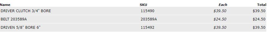

There is so much information coming at me from everyone here I must say I keep finding myself overwhelmed. Sorry I was off on my terminology, but at the time I was just trying to get the info out there and begin some dialogue. The links and pics have been immeasurably helpful, as well as the request for more detailed info. Being at work, I cannot get all of the info requested but I believe I have some direction on how to get more of what's needed, hopefully the info I put here will at least get some things started.
I will return the Amazon kit and have already ordered the Clutch Mount with Jackshaft from BMI. I am going to buy the Driver Clutch, Driven unit and belt from GoKartSupply. Here are what I have planned, I believe they all complement each other.
I'd also like to replace the chain while I am at it. From the video, I now know how to determine some difference and potentially how to measure what I need, but I don't understand the difference between the #40, 41 and 420, are those the height differences that MadProfessor was referring to? I will get a new Masterlink as well, that matches the one I end up with, I am just unsure of that last detail on chains.
Does it make more sense to get a sprocket with the key built in or w/keyway? Pretty sure the sprocket I took off had it built in, but I am replacing all of that with new, so want to order the right one.
