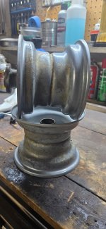

Got the rims clean. Gonna throw some paint on them too.

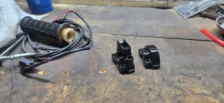

Painted the throttle housing.

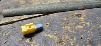

The kill switch was busted.

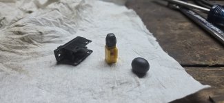

Drilled a small hole. Heated the screw and hot threaded it in.
Im thinking maybe some JB weld or that mush and mix putty. To cover the screw and make a button.
What say you guys?
