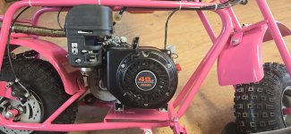

Had some tinker time.
Got the grips and cables installed.
Zip tied the cables to the frame. Kept it sleek running the throttle to the rear, instead of out the side.
Even got the kill switch through the magic box.
Carb and fuel line.
I added a stiffer throttle return spring. Dont need this hanging at half throttle when you let off.
Seat and tank installed.
This sides done i think.

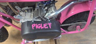

You have that custom made? How'd you do that? It still has the Rotaderp 212cc product number on it..
Nice mini, just about perfect details-wise. The "PIGLET" is imperfectly perfect or good enough for Piglet, as if he wrote it himself. Very fitting.

Hellion. I would have let the pipe naturally blue and been perfectly fine with that. But I added the galvanized pipe nipple and couplers. They would not color evenly and probably look like crap. So I covered them.
As for the sticker, I didn't even realize the 212 part number. It was funny that it claims 49cc. All over Amazon. I couldn't find one that said 212 at all. There's 2 common ones i saw.
