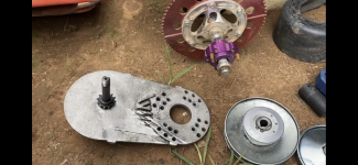

Lol, well I am doing more thinking/drinking then working. I saw the spring on your snap ring pliers and associated it to the springs I bought for driver.
Ok, now I see what you're saying. Draw a line across both pieces (for alignment reference) open this guy up carefully on the new one (so the spring doesn't fly out), and move the red spring to the left hole instead of the center one.
I've mounted and removed this thing a half dozen times. I can move the sprocket over by adding washers. I probably need notched washers if I actually use them but by the time I get it to clear the ribs I don't have enough rod left for the spacer and the lock washer. An alternative might be to replace the rod with a longer one. And then I'd have to replace something on the other side so the belt properly aligns.
The guy on YouTube running his backward cut his ribs off. He says he's done it this way on 2 carts and he's popping wheelies with no issues. I'm going to play around some more but so far all indicators are leading to removing the ribs.

Haha, I was just about to say that. The threads are too course. I have some but they're slightly shorter. They're not much shorter so they MIGHT be ok. What do you think? I'll definitely need a new bolt for the crankshaft. I think you posted sizes a little bit back.
I don't think I'll have any clearance issues. Especially when it's shifted over. I do see one huge issue. Those fins have gotta go or I'll never get a chain on it. Guess I'll be grinding tonight.
Yea those 3/4" bolts will be fine. Those threads in side cover are not very deep. Too long and they will break thur the side cover. Let's not do that!!!!
Here, get me another 🍺, and we'll get back to work, or at least think about work anyway.
You're gonna need to start at the axle sprocket. Get the little sprocket to line up with the axle sprocket, I would put a shim/washer between the sprocket and bearing, trying to keep the chain off that backing plate. Use a shim/washer, that's smaller then the outer bearing race. You want it to touch the inner race, but not the outer race.
Next, put a shim in between the sprocket and driven, trying to keep chain off the back side, outer edge of the driven. Sparks will fly and you will hear a bunch of grinding noises, if the chain is too close.
This is what keeps you from eating belts, very important.
Next, slide the back side of the DRIVER onto the crank shaft and see how far it's off from being lined up with the driven. You're gonna have to use that thick crankshaft spacer and some shims here, to get it PERFECT.
I use a flat file, it's hasn't lied to me yet and stays straight. Get those pulley's straight, and inline with each other.
Put the lil bronze ring on, belt and the rest of driver, look and see what it looks like.
If you need pics, lmk and i get some tomorrow.
Yea OK, I gotcha. I jus can't see how much they was in the way.
Don't use too many washers, try to use the least amount you can. A 3/4" I.D. washer will fit over the key stock. I use em all the time. It jus needs to take up space, not look pretty. Lol
