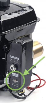

It's hard to see in the pic but the motor came with a manual throttle, I have to remove that and fab some kind of bracket for the throttle cable, but I'll cross that bridge when I get to it.

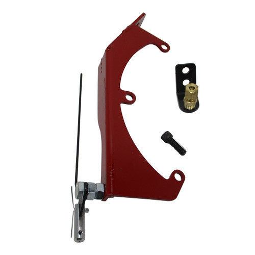

You just need one of these. It's worth mentioning this is the same throttle control bracket as the one for ungoverned engines it just includes the link rod for the governor arm; which you'd just remove from the assembly with the governor if you went that route after the fact.

That is a good idea but I'm cheap af and think I can fab something from sheetmetal or angle iron with my cutting wheel and flux core welding machine. I may try uploading the video to Google drive so I can share it.

I can't see your manual throttle setup (they all come with one) but if it is anything like a Rotaderp (Predator spelled backwards), then all you need is to loosen the friction screw that the throttle lever pivots on and... just do this:
You can buy an assortment of springs in a plastic box at Horror Fright or nearly anywhere. Maybe the dollar store has some...
EDIT--you can add the throttle return spring nearly anywhere on that throttle arm, further out on the arm for maximum leverage and with a longer spring might actually be better, not sure. I think some people have done that with the spring anchored somewhere on the blower shroud closer to the recoil starter, etc.
