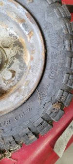

What size tires go on that 2 piece 4 lug steel rim?
I have 3 matching (4th is bent to hell) and might be what you need.
Iirc they might be 6", but they are definitely on 3/4" spindles
If you look back hellion posted a link to Walmart, and that is what I used to buy them. Best deal on the Internet. Thanks again hellion!

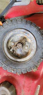

....I don't know if it is obvious from the pics but the rim was very rusted with severe pitting. I used my angle grinder and drill with wire wheels to strip as much rust and paint as i could, cleaned with alcohol and painted them. I cleaned the aluminum and clear coated it.
Fine work. I've had wheels in similar condition that I refurbished in the same way. Like I said previously, you could have filled in the pitting with a thin smear of Bondo or similar product, sanded it down smooth and then painted them. The pitting doesn't really matter though as the condition of the rims, especially where the tire bead rests, are not crucial to them holding air because they have inner tubes.
Which part is aluminum, the hubs?
EDIT: Show us pics of your engine!
Sorry I thought I posted pics. So my throttle pedal has a long bar that runs under the seat to attach to the cable there, so I'm pretty sure it really only needs 2-3 feet of cable and sheath. If I had a good bicycle brake cable laying around I would use it. Since I'm having to purchase the link I found was the closest thing and happens to be the cheapest I could find. Whatever I'll need to make it connect, I have my welding machine handy.
The hub on the wheel I refurbished is indeed aluminum, I shined it up and clear coated it.
