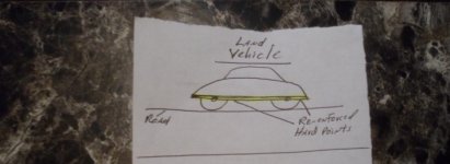

I still say you need steel attachment points for the suspension.
I've done a bit more thinkin' about this
...& some drawin' too ;)
Here are the designed "strong areas" &/or Hard Points on a:
Boat
Left side, of the pic shows (highlighted in yellow) how a boat has a re-enforced "rim" going around the structure
...&/also, a "spine" going down the center/bottom of the structure
Right side shows some of the potential impact areas
...& how/why these re-enforced areas are necessary
Plane
Top pic shows (highlighted in yellow) how a plane has re-enforced areas where the wings & tail section attach
...&/also, re-enforced areas where the wheels mount, that support the structure while parked & on take-offs & landings too
Bottom image shows another view of some of these "Hard Points areas
* Notice how the "hard Points" are strategically placed
...& NOT just all over the place/everywhere?
Land traveling vehicle
Top pic shows (highlighted in yellow) how a "car" has a re-enforcements where the wheels/suspension attaches
...&/also/maybe a couple re-enforced "strips" lengthwise, to kinda "connect" the front & rear "Hard Points" of the structure together
...of how/where the "Hard Points" are located
...& how they "connect" the front & rear sections together
