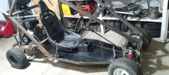

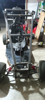

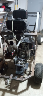

Perry, OH
I finally installed the floor this weekend, It looks good! My buddy and I are going in the nursery this weekend, so that will test durability. Also, the belt was destroyed chunks were missing. I found out that it plays into the burnouts, there was a lot of slack so by the time the engine reached full speed the clutch engaged and did burnouts. Now the gearbox has been shifted away from the engine slightly and the belt doesn't have much slack. The battery light installed needs one more wire but isn't necessary to charge. Also, have a flat in the back:(. 1707314790763.png1707314846643.png1707314894258.png
