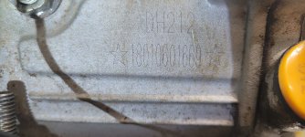

Yes, it does have 168F as a matter of fact. Being Dynocams saying the governor is preset to 5300, so I'm not entirely sure I would even need a Dover to keep up with it. It's definitely an odd looking LITTLE thing compared to what I'm used to seeing for coils. Even a Dover looks more like a factory coil than whatever that is on there now.
I don't see why a bigger bowl would hurt
I noticed that's numbers too.
Carb Yes, bowl no lol
All the ducars I've seen, every part starts with the DJ #
Idk what they mean. But they swap over with every thing else that is honda/clone sizes.
The case itself has DH behind where the starter would be and the low oil sensor stuff is.
When (not If) I do the electric start stuff to it, I'm going to hook the low oil to the ground leg of a warning light instead of the kill
(currently connected to itself so there's no dangling wires or open connections to be pesky)
I was reading that its a crude code in general that relates to the block stroke limit
1=single cylinder
68= bore diameter in mm
F= no one seems to know
Now We know that all factory 212's have a 70mm bore, HOWEVER it is according to Dynocams directly interchangeable with a GX200 which is a 68mm bore 196cc engine

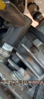

Since I happen to have a spare I decided to punch 8 of the 20 holes out in the Etube from their 026 (idk for sure, just guessing there) size to 030 (for sure) specifically for the lower mid range to lean it out.
Between that, and the fact I left the air filter off and likely having actual oil in the case... unloaded or not no more erratic gov, and no more flat almost a total stalling spot in the mid where the pilot is joined by the main.
I happen to still have a BPR8ES that was in good shape from where I eliminated all resistors from my 208's ignition system, which may have been a contributing factor in the improvement as well compared to the Autolite 3910X.
Only value any Autolite plug has to me is plugging the hole when painting a stripped head, or term storage of an engine... they are junk and being an "X" makes it that much worse

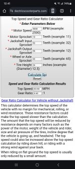

So you' re saying you have a 3.89:1 final drive with a 26" tall tire???
Or I'm missing something????
Primary is 52/10 = 5.2:1
Secondary is 30/36 = .833:1
30 series with 6" driven is .9:1
5.2
X
.833
X
.9
3.89:1
Is this right????
5.2
X
.833
X
.9
3.89:1
Is this right????

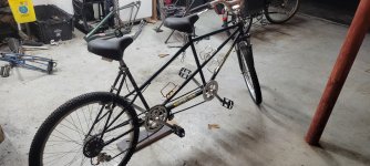

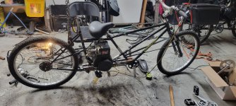

It's a project purely for shiggles using mostly what I have on hand... it began It's exsistance as a Tandem bicycle.
I can modify the jackshaft in and out if needed but the 52t was the largest I had to work with and 36 the smallest.
The axle has a common 7s Megarange Shimano cluster which iirc has a top gear of 32, and an end gear of 14 (32, 28, 26, 24, 22, 18, 14) seems about right.

I knew it was familiar when you said shifting points.
There was a guy that stop by here a couple years ago with a mountain bike, I think it was a 18 sp, I jus got outta the big CR engine builds and went back to gov builds then.
He done moved on now. But I was no help to him and his pred 212.
It was a interesting build, and seemed plenty sturdy and fast enough for street cruising, but not rugged enough for the hill climbing trails that surround this area.

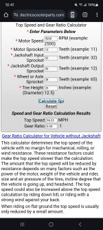

Lol I'm looking at too many numbers so mostly I just need someone familiar enough with both the Ducar 212 and the 30 series to get me back into the ballpark.
I wished I could help, those extra gears are throwing me outta loop.
It surely seems like that fella could only use 6 gears for his set up.
Idk why or which 6 gears, but I do remember he had it set so it wouldn't shift off the crank sprockets, it stayed on 1, but the rear he could shift.
Try what you have, you can always change the t/c jackshaft sprocket. They are cheap enough.
I set my t/c' s up like a powerglide transmission, low and high only.
If it dont slam into high and pull thur it, I'll gear it til the poor turd motor is outta breath. If that don't do it......I get a bigger turd motor.

That's because to run a jackshaft set up you need an FFW (front freewheel) crankset so the engine doesn't turn the pedals into a leg blender while using the engine to drive the rear wheel on the same chain line.
With a front freewheel like his, the engine power is jackshaft fed to the right side and down to the FFW which serves as the engine input and pedal power input to the rear wheel.
They can be front shifting by simply mounting a double or triple ring to the freewheel setup, but it's a nightmare not worth the trouble it tends to cause.
Oh indeed, and a 9t would bring me a lot closer to the 6:1 prefered range but I don't trust the 8t, I've heard they tend to explode which isn't shocking considering how thin the bore wall is on a 9t compared to a 10.
I run 415 chain so a new gear being a 41 has to get some profile shaved off by being mounted outboard of the driven, given a hand spin and brought up to speed under the grinder. Done well it stays concentric as it gets knocked back. Redoing the chamfer at the teeth tips is hell on the grinding disks but whatever. Once profiled I torch it til its straw colored and toss it in a can of old oil til I'm ready for it.
