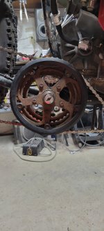

So the 9t refused to go on the new shaft so I mixed around old parts with new to get things together.
(I had to bore it over a bit and lightly sand the shaft I used it on to begin with)
I ended up needing a little more header clearance off sheaves (probably fine but I wanted to be sure) so I angle cut it a few times to tip it out and cut it off lower to swing it back in towards the frame. It's together and ready to test run tomorrow.

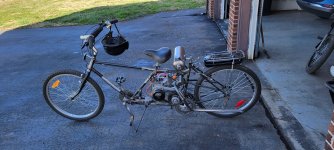

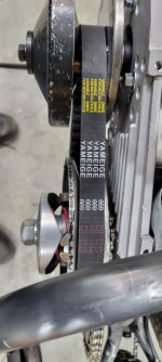

I decided to burn up the yak hair belt for tuning and I think it might be safe to put the 10t on it because it pulls so hard from a dead stop.
Being dark out and not having any lights beyond trying to keep a small flashlight pinned out on the road ahead.
I did discover that the weight difference between the original idea and this Ducar 212 has made the steering scary to keep it mild.
I know exactly what the issue is, resolving it simply... that's going to be a different animal entirely.
When I lowered it I end up with a 60° head angle with a 3/4" offset straight fork so the trail measurement say the steering axis is 10-11 inches ahead of the axle... I've got lots of caster but no trail.
I need to cut the steering angle from 60° to 35° or less (32°-36° is the common norm)

I remedied the steering angle with the original fork because it sweeps forward and brought the steer height down thus making the steering angle more upright, so the given geometry change in that makes the steering feel a lot more normal.
I may end up reworking the head angle anyway.

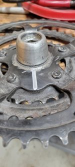

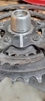

This nasty sucker ate the drive splines off the jackshaft gear I made, guess that what I get for using an aluminum part.
if the replacement does the same, at least Ill be able to weld it in place I guess.
