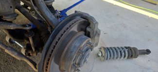

My tundra started clunking.

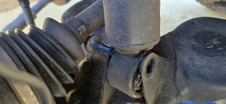

Wow. How did i not notice this before?
Both sides....
Got new struts. Easy peazy. 4 bolts and should be in and out...
Um, why you gotta be like this....

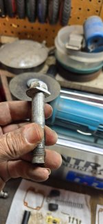

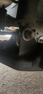

Looked like I was going to have to break a ball joint loose till I tried the swaybar link.
That gave me just enough room to sledge hammer and punch and pry bar the sucker out of there.
Mandatory carnage pic.
And F U flange.

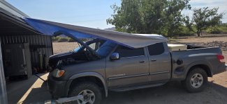

The suns beating down and i took a lesson from FA and his tarp shed...
Now for some lunch and then wrestle the other side.

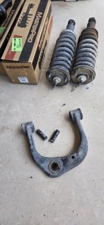

Upper a arm had some bad bushings on the driver side. Might as well change them too.
Finished driver side and went back to do the passenger.
Nothing like doing a job twice!
All driveways should have a 30’ permanent awning or open air carport connected to the house or garage (or free standing) otherwise cars just bake unnecessarily. In fact there should be more awnings period, all around the sun side of a house. Yeah I’ll get right on that.
