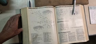

Time to break out the books. Haven't been in a 200r4 in a really long time. Maybe once.
These books are worth gold now days.

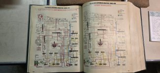

But the info on this page says theres a spring behind the valve.
But this one shows no spring. Hmm.

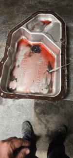

Pulled the pan.
Look at all that metal. 😔
Wasn't looking for a trans job out of this, but here it is.....

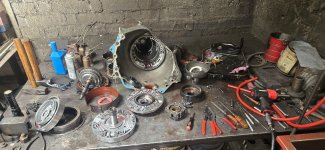

Tear down.
Where did the metal come from?
More inferior workmanship.
The pump wasnt assembled properly.
The halfs weren't aligned and it took a ton of prying and slide hammering to get it out.
If it dont fit just run it in with the bolts.
Morons.

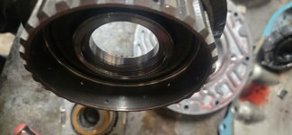

The clutch drums have a distinct dark color to them. This tranny has burnt up before.
Looking at everything else it has almost no miles on it.

So far a new planetary set and a new pump are in order.
This has the 7 vane pump and are known to be prone to fail.
Well see how the valve body fares later.
Worst part is trying to figure out which shift kit they used. No paper work or sticker to identify.
Found a blocked off hole in the separator plate and a land ground out in the pump.
Could be in the wrong spot and causing the issue but we dont have a stock one to compare to or the kits instructions.
