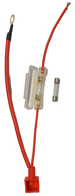

So in addition to the large cable from the battery to the solenoid and the 16 gauge wire running from switch lug B to the lug on the solenoid, I would also need a 16 gauge fused wire from the positive battery terminal to where on the solenoid?
Put it with the fat red wire from the battery to the solenoid. Here's an option.

Great....thank you. So positive battery to positive solenoid it is. For the sake of expanding my knowledge a bit, what does that wire do?
The wire in the link I sent? It's just a combination battery and fuse wire. I wanted to show you where the fuse wire went. It goes with the fat positive battery cable.
