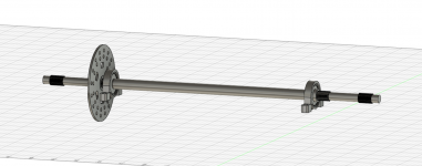

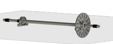

Today I finally found the rear axle that I am going to use :wai:
You can see it in this link---> https://es.aliexpress.com/item/4000...a4-0&pdp_ext_f={"sku_id":"12000020991650307"}
And I started to design it on the 3d cad, here is what I've made:
Captura de pantalla 2021-09-08 a las 23.26.53.pngCaptura de pantalla 2021-09-08 a las 23.27.13.pngCaptura de pantalla 2021-09-08 a las 23.27.04.pngCaptura de pantalla 2021-09-08 a las 23.27.54.png
One problem that I have is that I don't know how to install the braker to the frame because I can't see it in the picture of the link.
Captura de pantalla 2021-09-08 a las 23.32.14.pngCaptura de pantalla 2021-09-08 a las 23.32.03.png
Does any one know how to install it to the frame?
That's it for today😅
tomorrow I'll continue with it

madprofessor
"Loose Cannon Creations"
2,899
889
Jacksonville, Florida
Look at the caliper in the pic below. There's a sort of arch of blue square tube that goes up from the blue swingarm, goes over, and then that's blue angle iron that goes back downward to hold the caliper. The 3/8" or so nut you see is part of the caliper, no effect on mounting. Look a couple of inches to the left of it and you can see the tip of a small bolt coming through the black flat plate from the other side (through the angle iron also). That plate's about 3 times as long as the part you can see before the brake disc hides it. There's a 2nd one of those bolt tips sticking through from the other side down there, and those 2 bolts are all that mounts it.
The plate holes themselves are threaded, that's what the bolts are screwed into. Stick out any further and they'd hit the brake disc, my bolts are too long, so there's a few washers stacked up on the other side to stop them where you see the tip of that one.
Can't really tell if you have threaded holes on your caliper, but if you do it'll mount like mine. The stacked up washers is how you get the correct bolt length. NOTE: Everything but that flat plate just floats on rubber stems! The whole caliper except that flat plate can be wobbled around. You slide your brake disc on the axle until it's just roughly centered between the pads of the caliper, and tighten it to the axle.
TIP: Your hydraulic line's banjo bolt attaches to the end of one side of your V-shaped (on that side anyway) caliper body. The other side of the V-shape has a rubber "stud" sticking up, that's a rubber cap over the brake fluid bleeder valve. Install your and all calipers with the bleeder at the highest point of the caliper body, because air rises in a fluid, and it's air you have to bleed out. You can see the rubber "stud" on my caliper is sticking straight up from the highest part of my caliper body.

Davidgo06

So I'll have to put a flat plate on the frame and put the braker with the bolt to the flat plate?

madprofessor
2,899
889
Nope, that's a rubber stud that the thin plate there floats on. The other, thicker plate would be the one with threaded or otherwise holes in it.
Magnifying the pic, looks to me like there's 2 holes on the right edge and the top of that thicker plate. Guessing they're mounting holes.
madprofessor
2,899
889
That's the best I can figure from what the pic looks like on my screen here............and I figure that by my own experience with the cheap Chinese setup on my current kart, and using what little common sense I still have.
It has to mount up somehow, and that would require at least 2 holes in something solid (steel part) for the solid stability required to keep it fixed and centered over the brake disc. The 2 rubber studs required to allow the parts to float are very obviously staubbed into the 2 metal 'fingers" of the body.
1 of the plates holding 1 brake pad has to be secured solidly to the frame (those 2 bolt holes you've circled), while the body itself and the other plate holding the 1 other brake pad have to float. When the piston extends as hydraulic pressure from the master cylinder forces it out, the body will push away from the solidly mounted plate, pulling the other floating plate with it. That will put both brake pads (1 on each of the solid and the floating plates) in contact with the disc, squeezing it however hard you push the pedal.
Hopefully this will allow you to see the setup, so you can figure in advance what you've got to do for creating a mounting for the caliper. Don't forget that the bleeder valve needs to be at the uppermost part of the caliper when mounted.
